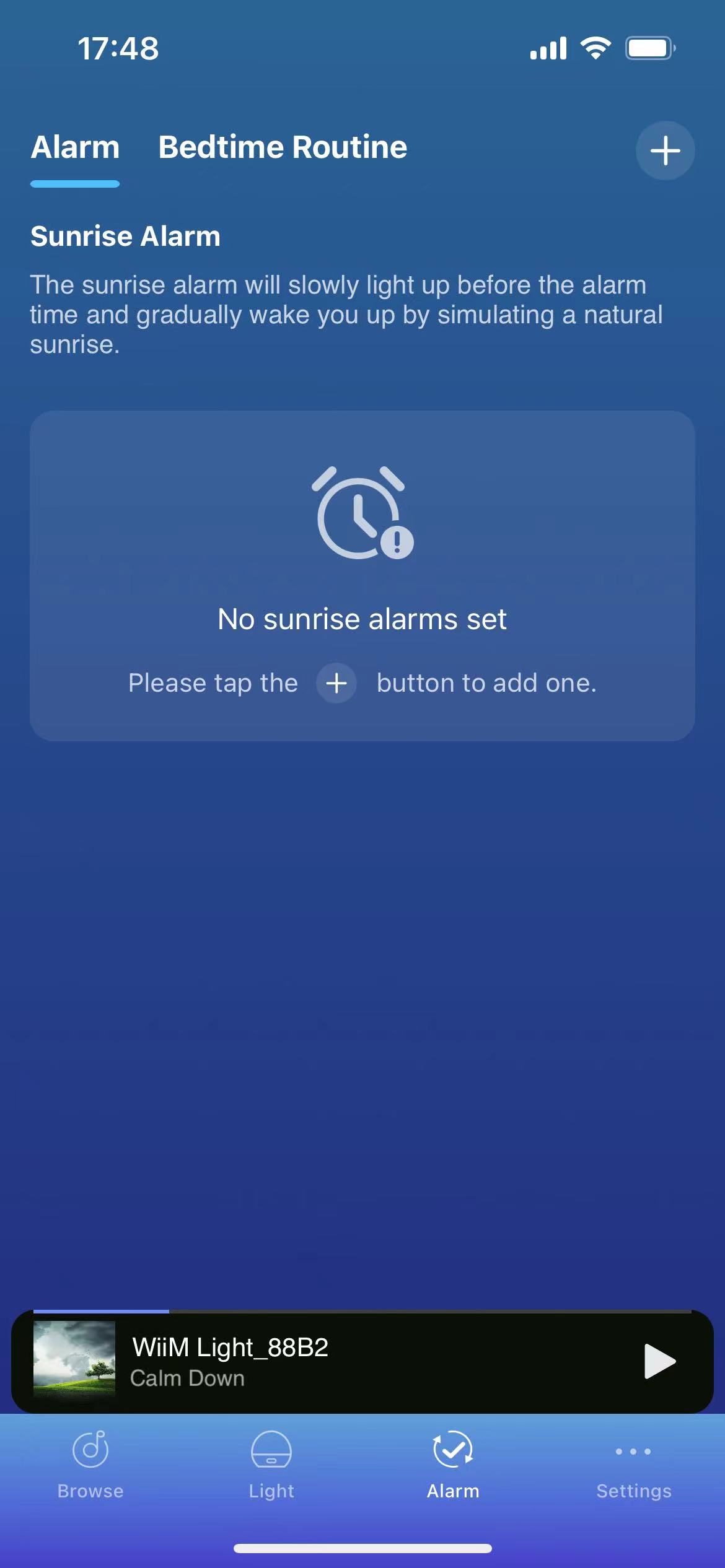

Follow these steps to set up an alarm in the WiiM Light app:
  1. Open the WiiM Light app.
  2. Go to the Alarm tab.
  3. Tap the icon in the top-right corner to add an alarm.

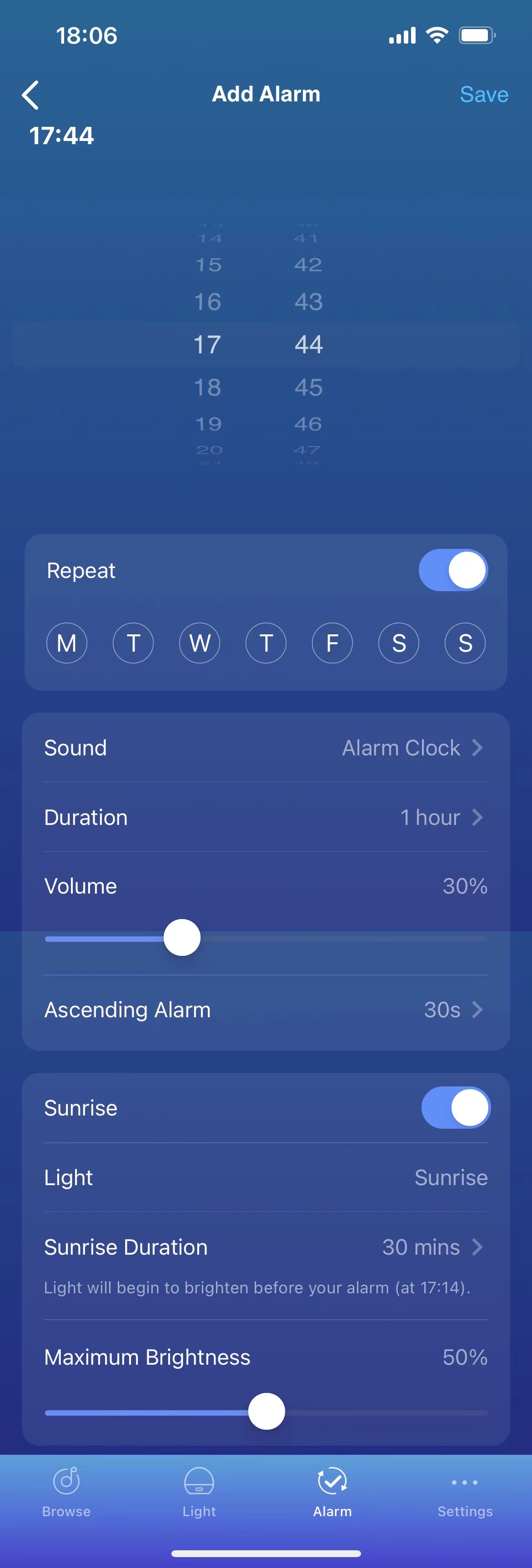

  4. Specify the following alarm settings:
    - Alarm time
    - Whether to repeat the alarm on specific days of the week
    - Alarm sound
    - Alarm duration
    - Volume level
    - The duration of gradually increasing alarm volume
    - Sunrise feature. When enabled, specify the sunrise duration and maximum brightness to simulate a natural sunrise.
        Note: If the sunrise feature is configured, the sunrise light will gradually brighten before the alarm goes off.
  5. Tap Save in the top-right corner to finish.

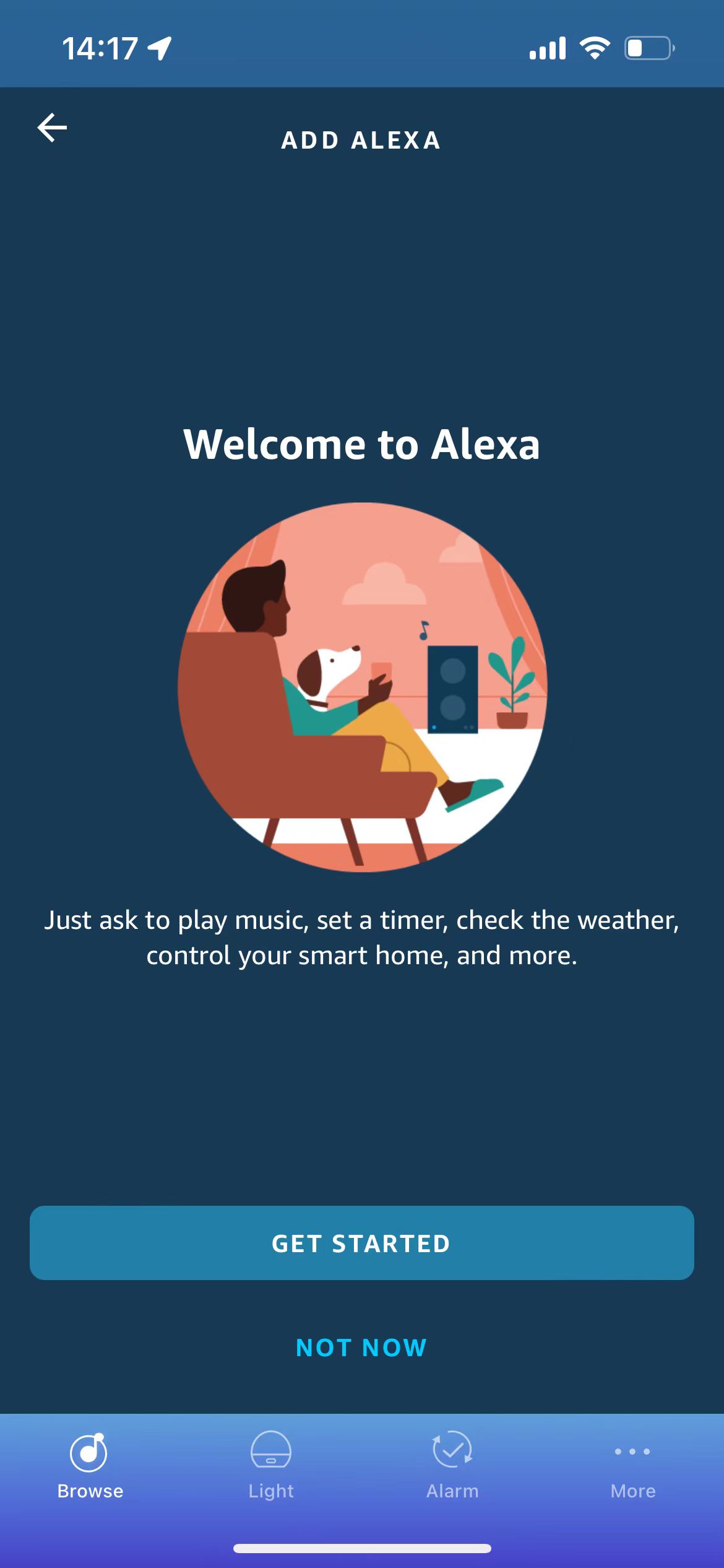

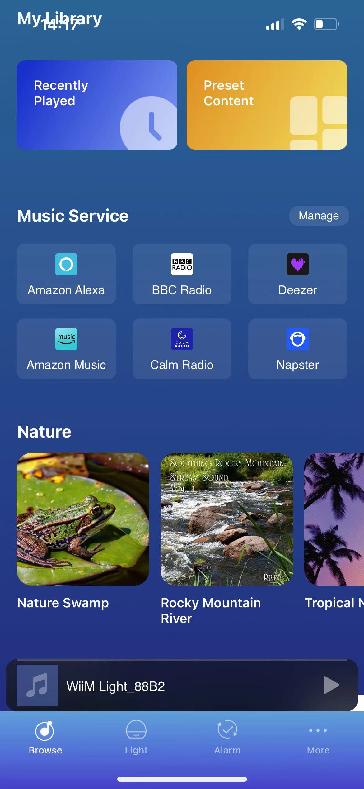

Before using Alexa voice commands for the first time, you need to log into your Alexa account from the WiiM Light app:
  2. Go to the Browse tab.
  3. Select Amazon Alexa in the Music Service section.
  4. Tap GET STARTED and then follow instructions to log into your Alexa account.

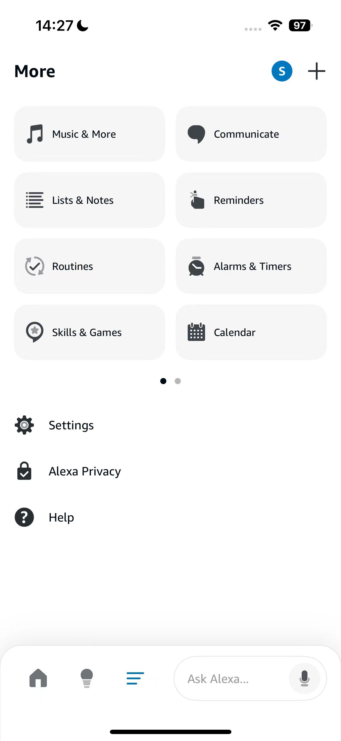

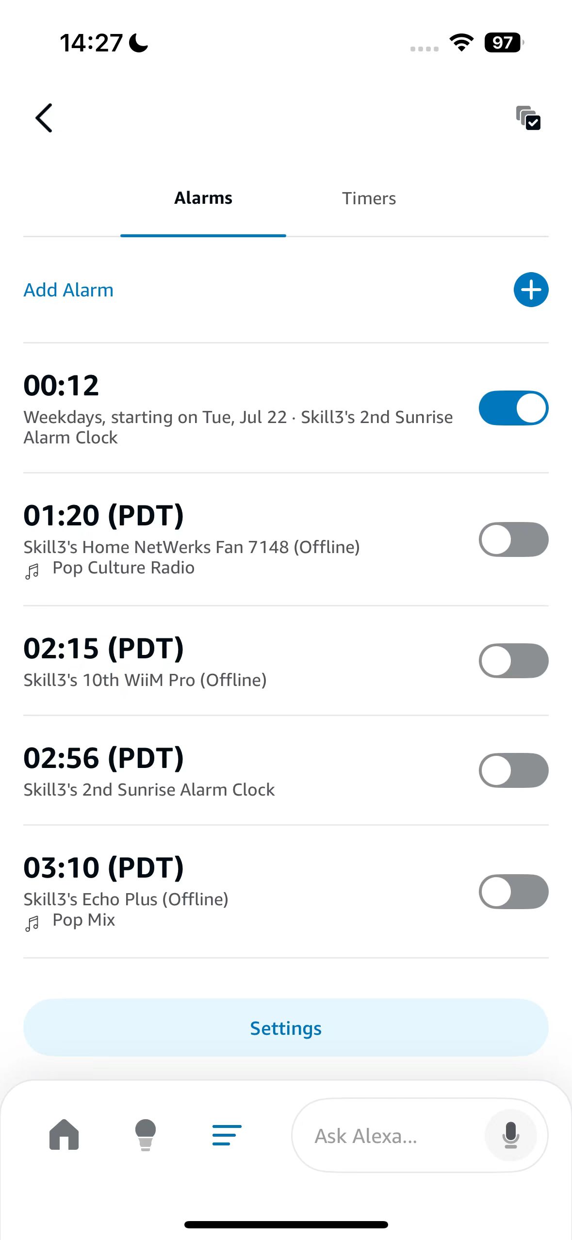

Using the Alexa App
You can also set up an alarm in the Alexa app by following the below steps:
  1. Open the Alexa app.
    Note: Make sure to log in to the same Alexa account in both the Alexa app and the WiiM Light app.
  2. Tap the icon at the bottom of the Alexa app, and then select Alarms & Timers.
  3. Tap the icon to add an alarm.
  4. Select your WiiM Wake-Up Light device and adjust alarm settings.
